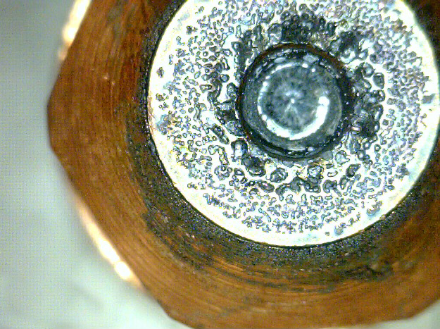

  • If the electrode pit diameter extends beyond the hafnium, as shown, replace the electrode and nozzle.Used electrode with normal pitting extending beyond hafnium.

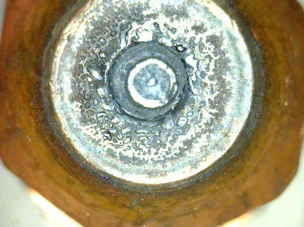

  • If you see a non-symmetrical, rough-edged pit and rough-surfaced electrode face, replace the electrode and nozzle. Always replace the nozzle at the same time as the electrode.Used electrode with non-symmetrical pitting.
