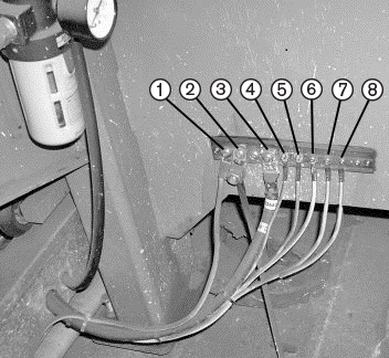

The following picture shows an example of a gantry ground bus. It is bolted to the gantry, close to the motor. All of the individual ground cables from the components mounted on the gantry connect to the bus. A single heavy cable then connects the gantry ground bus to the table ground bus.
Figure 2. Gantry ground bus example
Example of a gantry ground bus
1 Cable to the cutting table ground bus
2 Ground cables from components on the gantry
