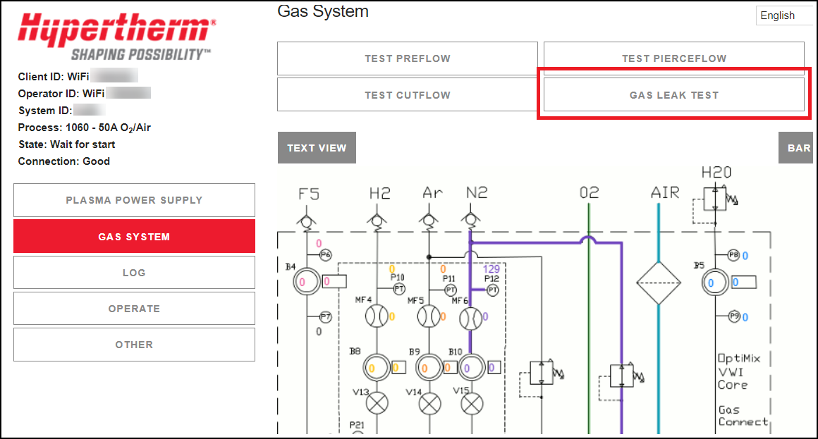

Gas leak tests in the XPR web interface
When you select GAS LEAK TEST in the XPR web interface:
  1. The GAS LEAK TEST button is highlighted with red to show that it is active, and the test has started.
  2. The active valves are identified with colored highlights.
  3. The gases shown on Line A, Line B, and shield are different for different process IDs. You can do a gas leak test for Line A (black) and for Line B (yellow) but not for the shield gas line (blue).
  4. The gases flow until you select the same button or select a different button that interrupts the test.
Figure 1. GAS LEAK TEST in the XPR web interface
This image shows the GAS LEAK TEST button in an example web interface screen.
  • After you complete a gas leak test in the XPR web interface, select the LOG button to see the result of the test.
  • The Log screen shows if the test was successful.
  • For a test that was not successful, look for information on the Log screen that identifies the point of failure.
  • Use the information from the Log screen and the wiring diagrams for your system to find the location of the gas leak.
