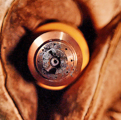

  • Carefully remove molten metal that collects in the castellations of the drag-cutting cartridges.
    Do not push the unwanted material inside the nozzle or shield.
    This image shows a cartridge with buildup on it.
  • Carefully remove molten metal that causes a blockage of the airflow holes in the shield.
