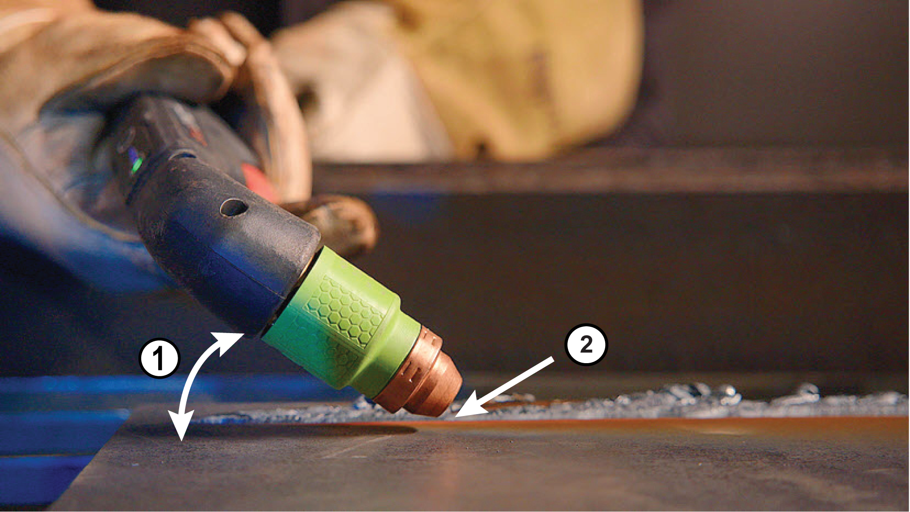

Start a gouge angled to the workpiece
  1. Before firing the torch, hold the torch at approximately a 40° – 45° angle to the workpiece with the torch tip approximately 6 mm – 12 mm (1/4 in. – 1/2 in.) from the workpiece.
    This image shows a torch at a 40° – 45° angle.
    1 40° – 45° angle
    2 6 mm – 12 mm (1/4 in. – 1/2 in.)

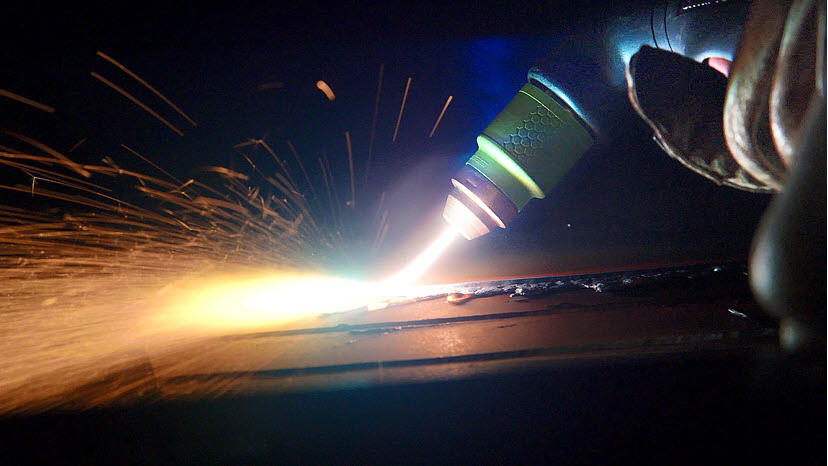

  2. Pull the trigger to get a pilot arc and transfer the arc to the workpiece.
  3. Stretch the arc to 25 mm – 32 mm (1 inch – 1-1/4 inches).
    This image shows the torch with an arc stretch.

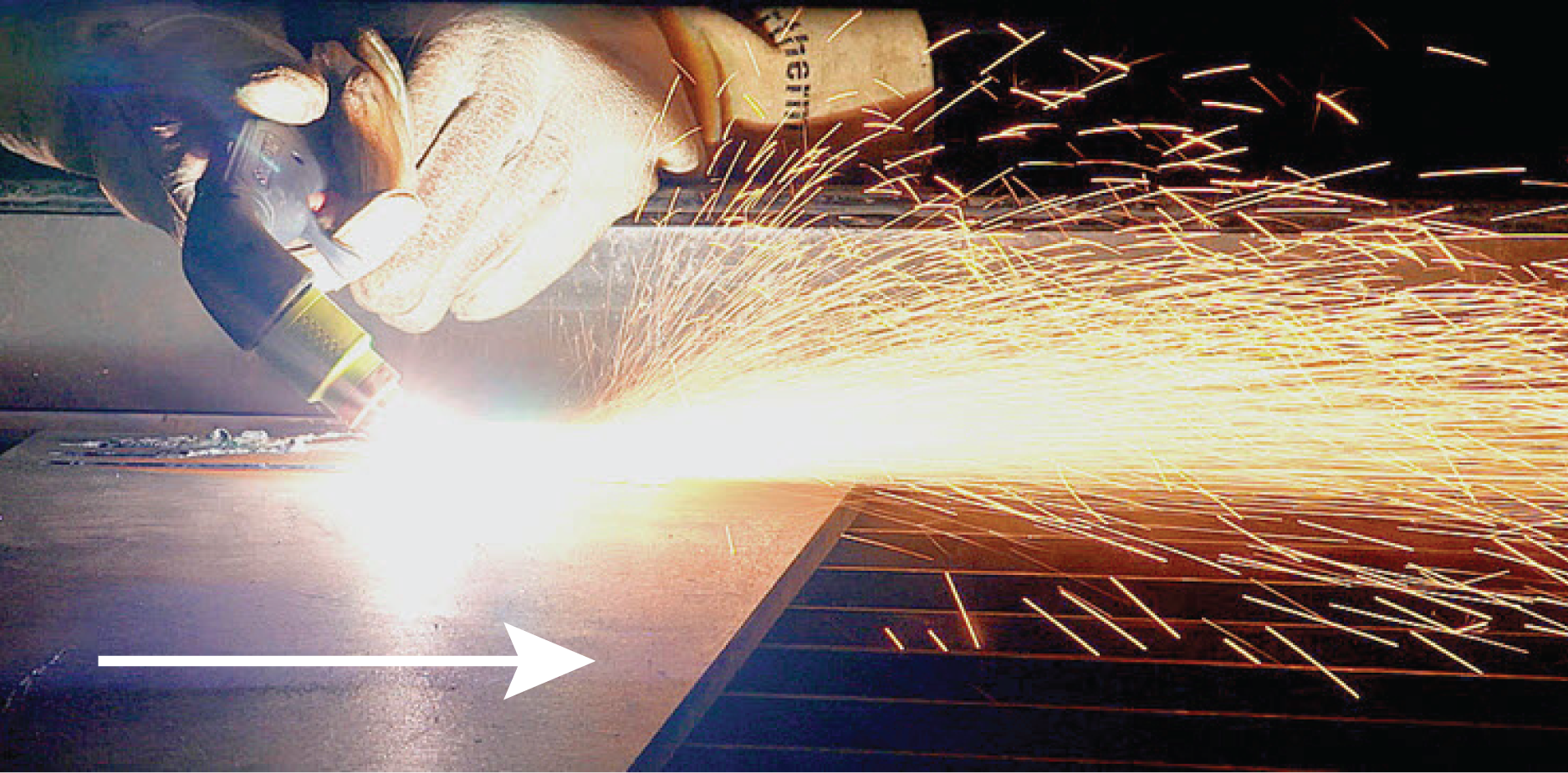

  4. Keep this position as you push the plasma arc in the direction of the gouge that you want to create.
    This image shows a torch gouging and identifies the direction of travel.
