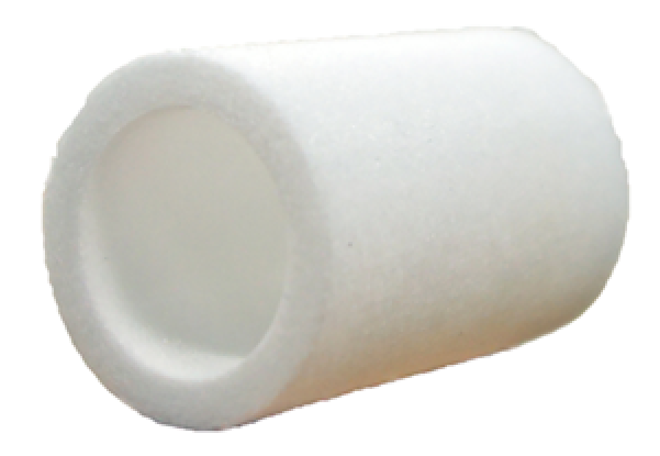

  1. Examine the air filter element in the plasma power supply’s built-in air filter.
    The image shows a clean filter element.
  2. Replace the filter element if it is dirty.
  3. Clean the air filter bowl to remove oil, dirt, and other contaminants.
    A yellow residue on the filter bowl shows that oil is getting into the gas supply line.
  4. Replace the O-ring at the top of the air filter bowl if it has cracks or other damage.
