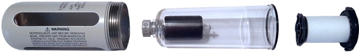

Remove the air filter bowl by unscrewing the metal guard until it disconnects
from the air filter assembly inside the plasma power supply.
- Remove the air filter bowl from the metal guard.
Gently pry the filter element out of the filter bowl.
Be careful not to damage the O-ring at the top of the bowl.

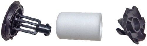

Twist the plastic fittings until they come apart, approximately a 1/4
turn.
Set the fittings aside.
Put the new air filter element in the plastic fittings.
Twist the plastic fittings until they lock together, approximately a 1/4 turn.
Clean the air filter bowl by wiping away any oil, dirt, or other
contaminants.
Note:
A yellow residue on the filter bowl can be a sign that oil is getting into the gas supply line.
- Examine the O-ring, and replace it if it has cracks or other damage.
Put the O-ring at the top of the filter bowl.
Put the filter element inside the air filter bowl.
Push down on the top plastic fitting until you hear a click.
- Put the air filter bowl inside the metal guard.
Put the air filter bowl back into place by screwing the metal guard into the
air filter assembly that is inside the plasma power supply.
Keep the metal guard straight so that you do not damage the threads as you install it.
