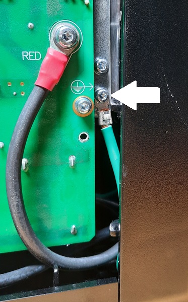

  5. Measure the resistance from the input leads to ground to make sure that it reads as open.
    • For all models, make sure that the resistance from input to ground is >20 megaohms (MΩ).
    • With the electric power disconnected and the power switch set to OFF (O), make sure that all circuits read as open.
    • The electrical values shown are ±25%. However, this range is intended only for reference. Resistance values can vary widely depending on the type of multimeter and the polarity used to measure the readings.
    The image shows where to find the ground connection.
