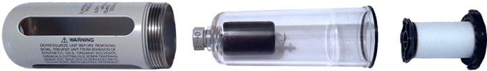

    The image shows a disassembled air filter bowl.
  5. Twist the plastic fittings until they come apart, approximately a 1/4 turn.
    Set the fittings aside.

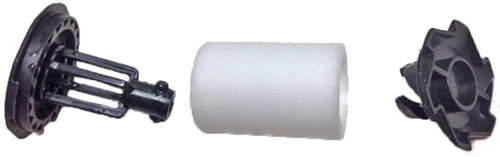

    The image shows the air filter removed from the two plastic fittings.
  6. Put the new air filter element in the plastic fittings.
    Twist the plastic fittings until they lock together, approximately a 1/4 turn.
    The image shows a new air filter surrounded by the plastic fittings.
