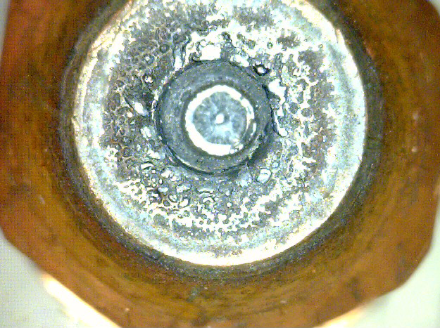

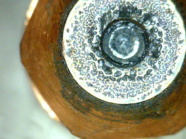

Examine the electrode for emitter wear
Emitter wear can indicate when to replace the electrode. Increasing the number of starts and the arc-on time can cause the emitter to wear more quickly. Emitter wear can cause the cut quality to decrease. Your cut-quality requirements will indicate when to replace the electrode.
| 1 | Electrode pit |
| 2 | Hafnium emitter |
| 3 | Electrode face |
Note:
If an electrode needs replacement because of emitter wear, always replace the nozzle at the same time as the electrode. Use the electrode torque tool (429013) to correctly tighten the electrode.
