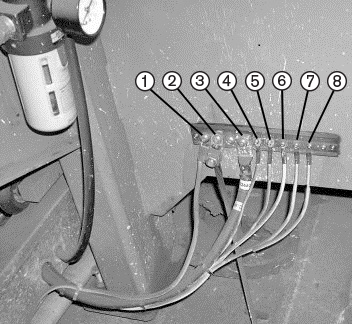

Figure 1. Plasma cutting system components connected to a cutting table ground bus
1 Gantry ground bus
2 Ground rod
3 Plasma cutting system work cable (+)
4 Gas connect console
5 CNC enclosure
6 Torch holder
7 Plasma cutting system chassis
8 TorchConnect console
Cooler, if applicable (not shown)

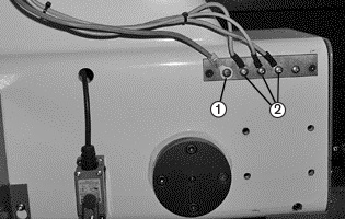

The following picture shows an example of a gantry ground bus. It is bolted to the gantry, close to the motor. All of the individual ground cables from the components mounted on the gantry connect to the bus. A single heavy cable then connects the gantry ground bus to the table ground bus.
Figure 2. Gantry ground bus example
Example of a gantry ground bus
1 Cable to the cutting table ground bus
2 Ground cables from components on the gantry
