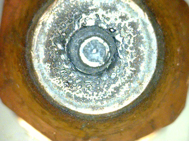

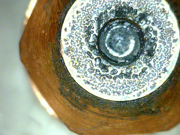

  1. Examine the electrode pit diameter for these conditions:
    1. If the diameter extends beyond the hafnium, replace the electrode and nozzle.
      This image shows an example used electrode with pitting that extends beyond hafnium.
    2. If you see a non-symmetrical, rough-edged pit and rough-surfaced electrode face, replace the electrode and nozzle.This image shows a used electrode with non-symmetrical pitting.
