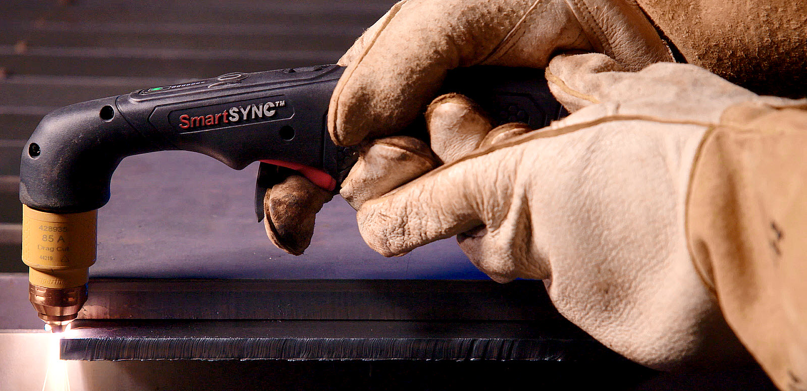

  1. With the work clamp attached to the workpiece, hold the torch tip perpendicular (90°) to the edge of the workpiece.
    This image shows a SmartSYNC torch at the edge of a workpiece.

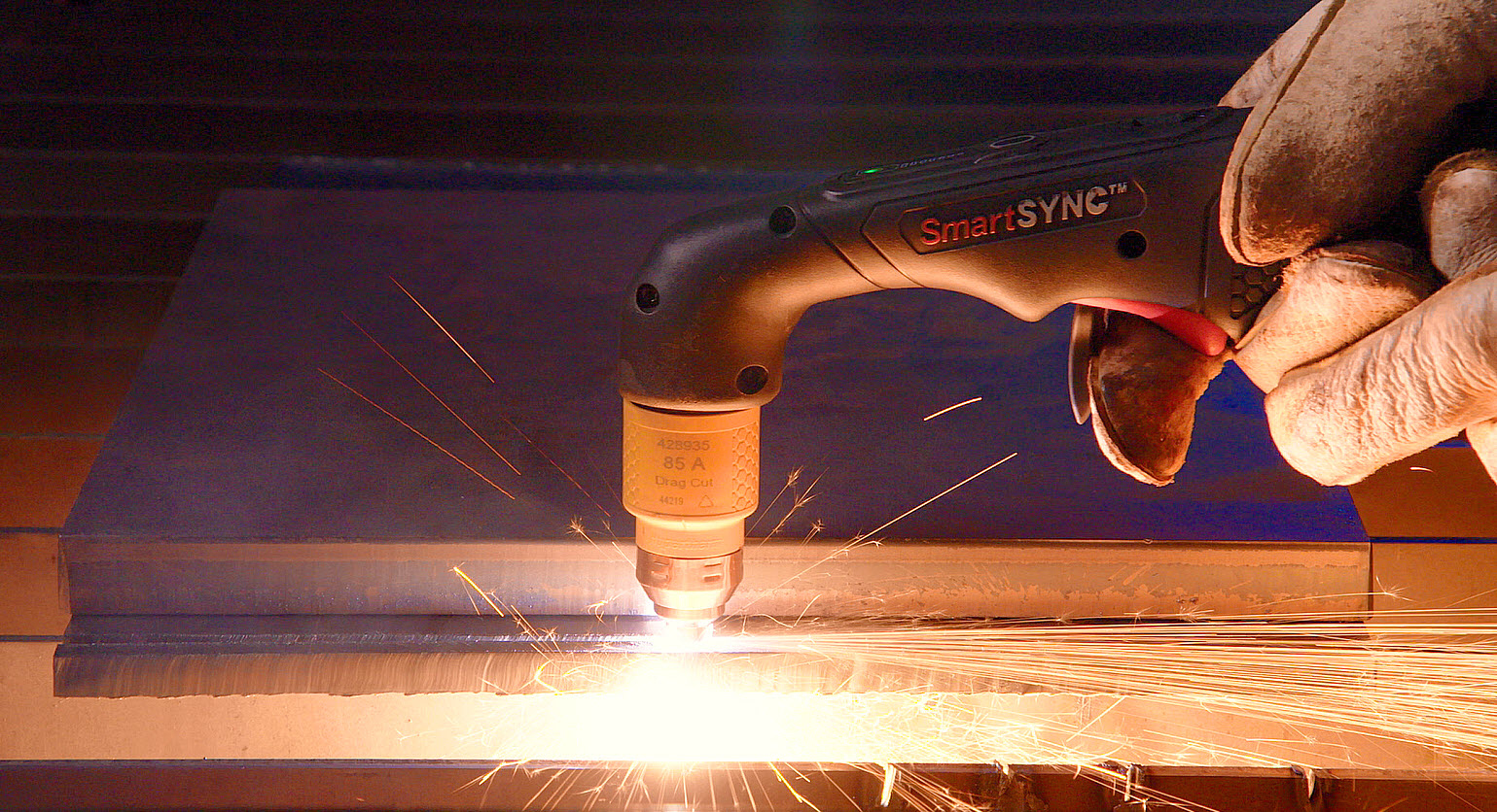

  2. Pull the torch trigger to start the arc.
    Stay at the edge until the arc has cut completely through the workpiece.
    This image shows a SmartSYNC torch with a plasma arc.

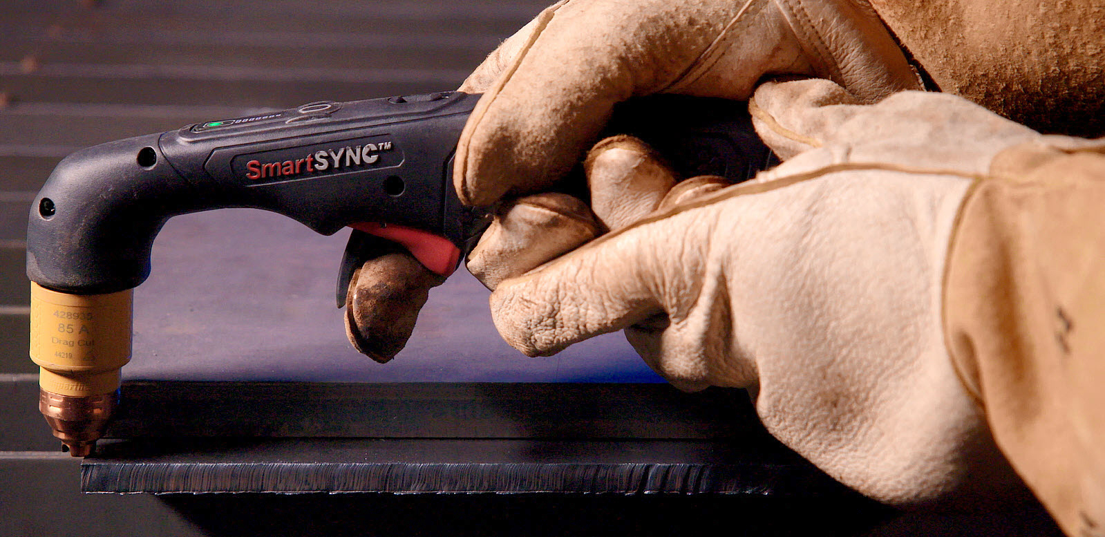

  3. Drag the torch lightly across the workpiece to continue with the cut.
    Keep a smooth, stable pace.
    This image shows a SmartSYNC torch dragged along the workpiece.
