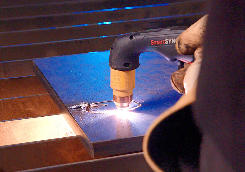

The hand torch can pierce interior features on metal. The type of pierce that you do
relates to the thickness of the workpiece and the pierce capacity of the system.

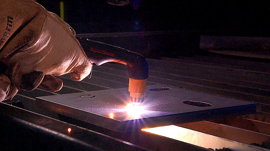

Straight pierce
Use a straight pierce to cut a workpiece that is thinner than 8 mm (5/16
inch). If a straight pierce does not pierce the workpiece, try a rolling
pierce.

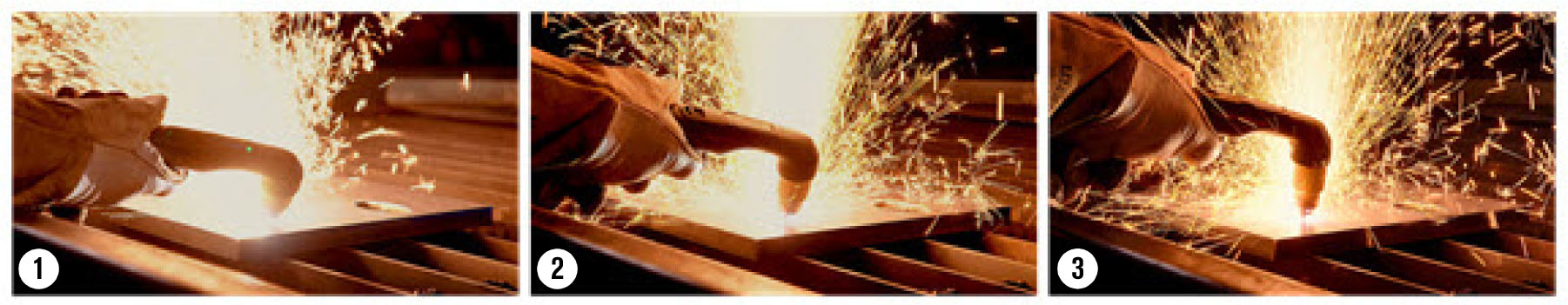

Rolling pierce
Use a rolling pierce to cut a workpiece that is 8 mm (5/16 inch) or thicker,
or if a straight pierce does not pierce the workpiece.

Straight pierce
Hold the torch perpendicular (90°) to the workpiece.

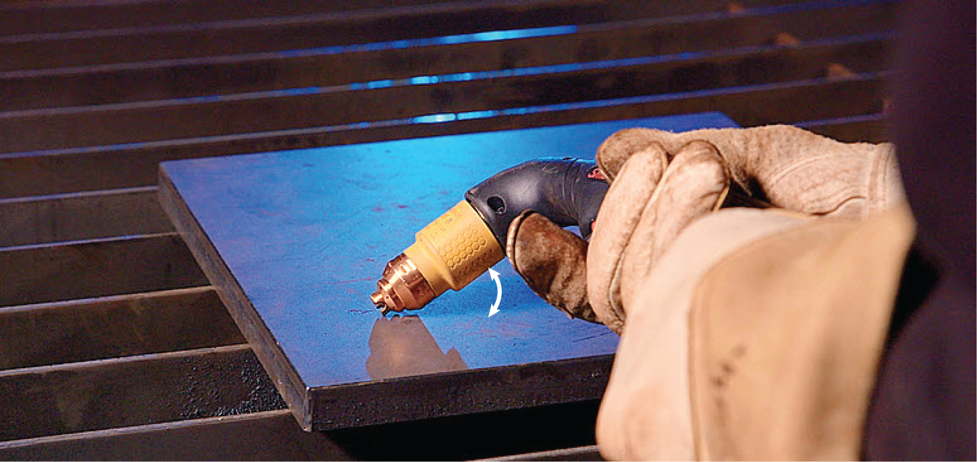

Rolling pierce
Hold the torch at an approximate 30° angle to the workpiece with the
torch tip touching the workpiece before firing the torch.

Straight pierce
Pull the torch trigger to start the arc.
Rolling pierce
Pull the torch trigger to start the arc while still at an angle to
the workpiece, then move the torch up to the perpendicular (90°)
position.
Hold the torch in position while continuing to pull the trigger.
When sparks are coming from below the workpiece, the arc has pierced the
material.
When the pierce is complete, drag the torch tip lightly across the workpiece to
continue with the cut.
