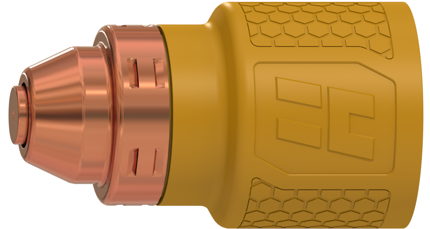

Hypertherm® offers the following types of hand-cutting cartridges, which can be used with both the 15° and the 75° SmartSYNC® hand torches:
Cartridge type Purpose
The image shows a drag-cutting cartridge. Drag-cutting (yellow) Use these cartridges to drag the torch on the workpiece (drag-cut) for the widest range of cutting applications.
The image shows a FineCut cartridge. FineCut® hand (yellow)
Use these cartridges to get a narrower kerf on thin mild steel and stainless steel up to 3 mm (10 gauge).
Also use these cartridges to mark mild steel, stainless steel, and aluminum. Refer to Marking process guidelines.
