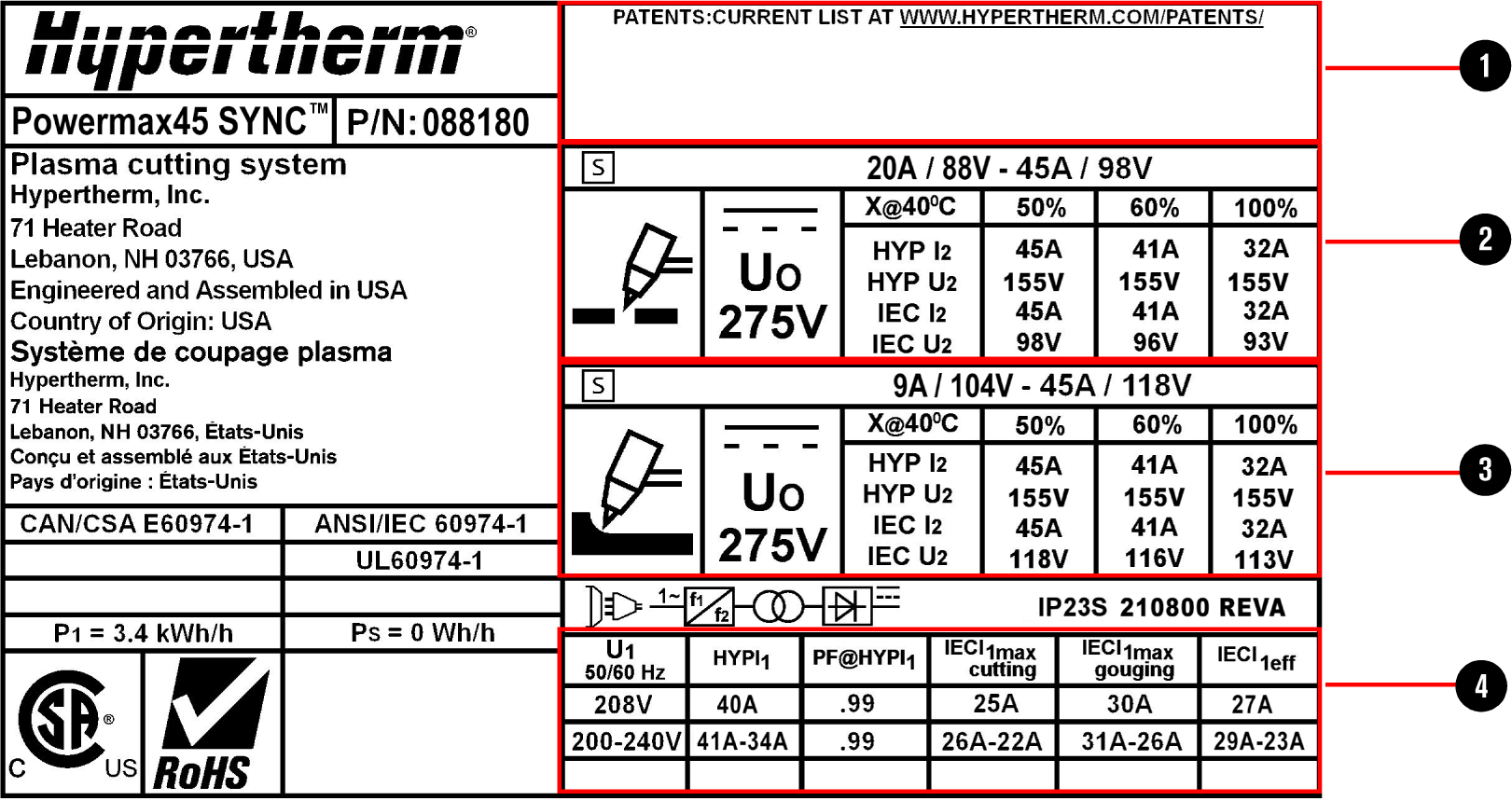

System specifications on the data plate
The data plate on the plasma power supply shows two sets of ratings: one for the International Electrotechnical Commission (IEC) and one for Hypertherm®.
  • The HYP ratings are Hypertherm plasma power supply ratings. They show the capability of the system related to the internal testing done by Hypertherm.
  • The IEC ratings are the minimum ratings that the system must get to meet the requirements of IEC standard 60974-1.
CSA and CE/CCC data plates have small differences.
Figure 1. CSA data plate example
The image shows an example of a data plate with callouts pointing to different sections.
1 Serial number, bar code, and date made
2 Plasma cutting ratings
3 Plasma gouging ratings
4 Plasma power supply ratings
HYP
Hypertherm internal rating
IEC
IEC rating
I1
Input current (A)
I2
Conventional welding current (A)
PF
Power factor
U0
Rated no load voltage
U1
Input voltage (V)
U2
Conventional welding voltage (V)
X
Duty cycle (%)
