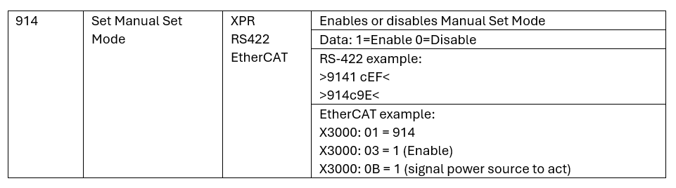

  1. From the Computer Numerical Control (CNC) screen or other control device use command 914 to choose the condition you want: OptionDescription
    To enable manual-set mode Choose 1=Enable in the Data field. When manual-set mode is enabled, the DISABLE button shows red.
    To disable manual-set mode Choose 0=Disable in the Data field. When manual-set mode is disabled, the ENABLE button shows gray.
When manual-set mode is enabled, the cutting system automatically uses the process that is set in manual-set mode every time power is supplied to the cutting system and until that process is canceled or changed.
