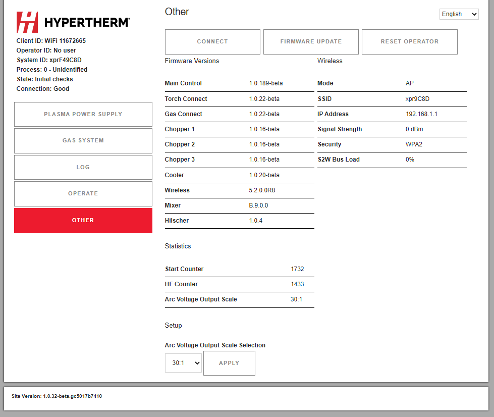

  2. Go to the Other screen.
    The Other screen.
  3. Use the dropdown menu under Setup to choose the Arc Voltage Output Scale that you want.
    The default voltage ratio is 30:1.
    Dropdown menu to choose the Arc Voltage Output Scale on the Other screen.
  4. Choose Apply .
