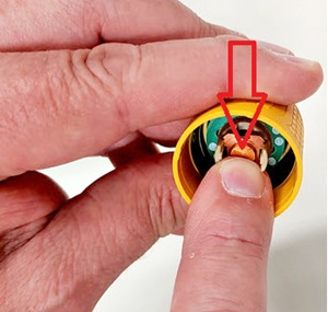

  • Examine the crown. The crown is the square copper piece inside of the cartridge. Push down the crown and then release the spring tension.
    This image shows the location of the crown.
    A crown in good condition goes back to its start position. If the crown stays in the down position, carefully shake the cartridge. If the crown continues to stay in the down position, replace the cartridge.
