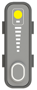

Controls and indicators on the hand torch
The SmartSYNC® torch has a status indicator Light Emitting Diode (LED).
This image shows each status indicator Light Emitting Diode on the torch.
1 Status indicator LED
2
LED OFF = System is in Cut mode
LED ON = System is in Gouge mode
3 Power output level
4 Current adjustment switch
Table 1. Status LED colors
LED color Meaning
This image shows a green light on the control indicator. Green = Prepared to cut.
This image shows a yellow light on the control indicator. Yellow = Torch is locked.
This image shows a red light on the control indicator. Red = An internal system component is possibly faulty.
