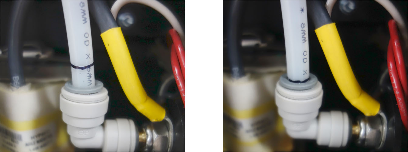

  1. Push-to-connect the smaller diameter end of the 90° fitting onto the front panel brass torch fitting.
  2. Push-to-connect one end of the of the shorter gas supply hose into the 90° fitting.
    Insert the hose far enough so the marked line reaches the connector, as shown.
    The image shows the push-to-connect depth requirement.
  3. Push-to-connect the other end of the shorter gas supply hose to the solenoid valve assembly.
    Insert the hose far enough so the marked line reaches the connector.

  5. Push-to-connect one end of the longer or looped gas supply hose to the solenoid valve assembly.
  6. Loop the gas supply hose around (if needed) and push-to-connect the other end to the air filter assembly.
    Insert the hose far enough so the marked line reaches the connector. The bottom of the loop should rest on the plastic shelf to the left of the fan.
