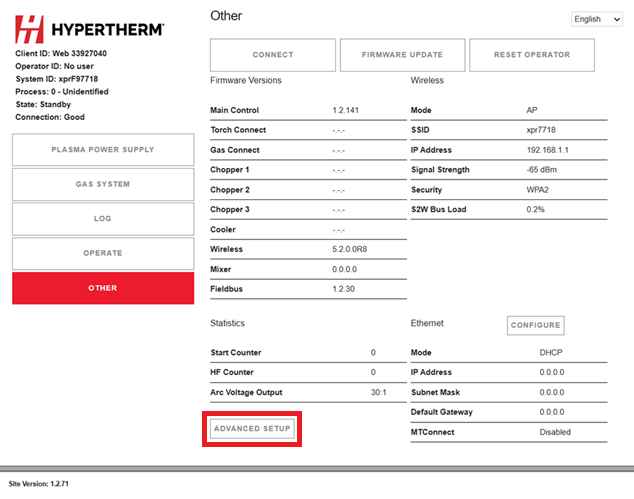

  2. Go to the Other screen.
    This image shows an example Other screen with a red box around Advanced Setup.
  3. Choose ADVANCED SETUP to get access to the Arc Voltage Output Configuration menu.
