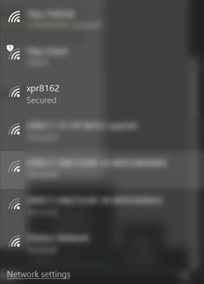

  2. On your device, go to the wireless connections menu.
    This menu can be different on different devices.
  3. Choose the XPR® connection.
    The default connection name is "xpr" + the System ID. The System ID is the last four digits of the Media Access Control (MAC) address. For more information about the System ID and MAC address, refer to Web interface screen information.
    If you want to change the connection name or password, refer to Change the limited AP settings Other screen.
    This images shows the wireless connection for the XPR
  4. Enter the password.
    The default password is hypertherm. If you want to change the connection name, refer to Change the limited AP settings Other screen.
