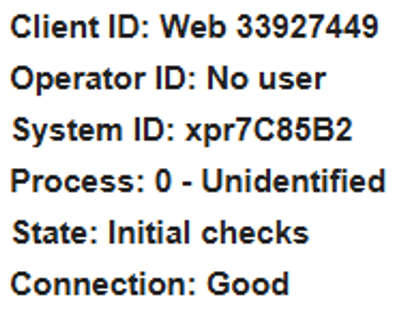

Operator ID
This is the identifier for the device or client that has control of the plasma power supply. The first part of the Operator ID shows the type of connection that sent a process, Web for wireless or Ethernet LAN, Uart 422 for serial RS-422, or EtherCAT for EtherCAT®.
This image shows details that identify the device or client that has control of the plasma power supply.
To change which device has control of the plasma power supply, refer to Change the device that has control.
Client ID
This is the identifier for a device that communicates with the plasma power supply. This ID uses the Coordinated Universal Time (UTC) timestamp and is saved in a browser cookie.
If the Client ID and the Operator ID are the same on your device, you are in control of the plasma power supply.
