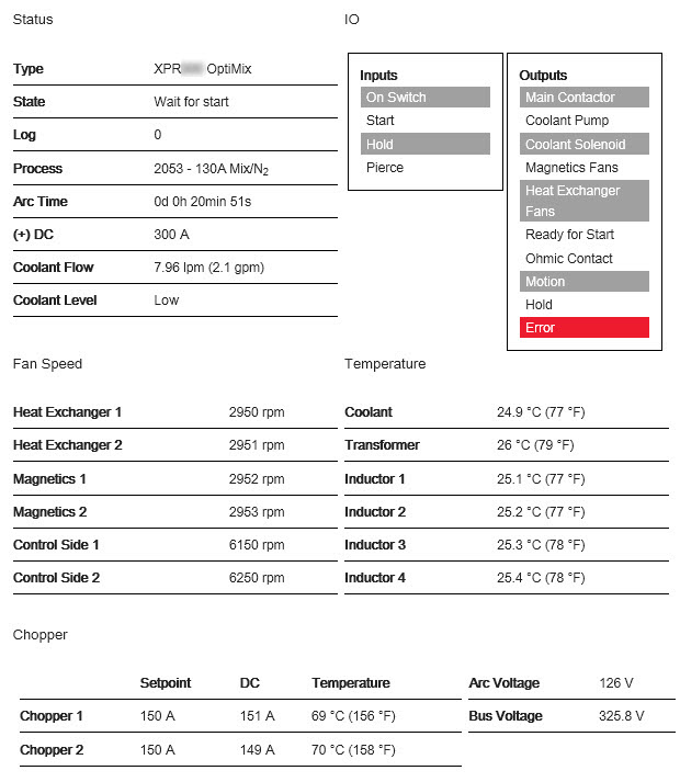

Plasma power supply screen
On this screen you can monitor the status of the plasma power supply. This screen also shows a list of inputs and outputs. When an input or output is active, the screen shows it as red or gray.
Figure 1. Example of the plasma power supply screen
Note:
The XPR® web interface shows different fields for different XPR models. The screen shown is for reference only.
