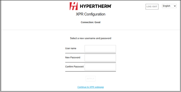

      This image shows the Sign in to access this site prompt that shows the first time a user attempts to access the site.
      The default user name is "xpr" and the default password is "hypertherm."
    2. Enter a new user name and password in the XPR Configuration screen.
      This image shows an example XPR Configuration screen where users enter a user name and password.
