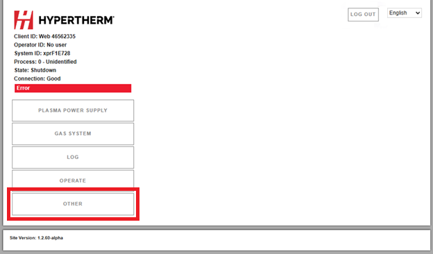

  2. On the main screen for the XPR web interface choose OTHER.
    This image shows an example main screen for the XPR web interface.

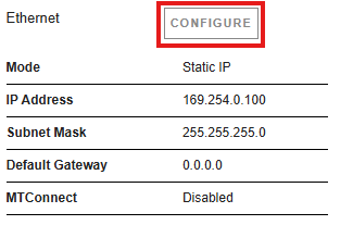

  3. Choose CONFIGURE.
    This image shows the Configure button on an example XPR Ethernet screen.

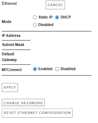

  4. Choose the settings you want for the connection-mode option you have (Static IP, DHCP) or MTConnect (Enabled or Disabled).
    This image shows an example Ethernet configuration screen with Dynamic Host Configuration Protocol mode and MTConnect enabled.

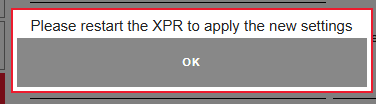

  6. Choose APPLY to save the choices you made.
    Restart your cutting system if the XPR web interface prompts you to restart.
    This image shows an example prompt to restart your cutting system from the XPR web interface.
The Ethernet settings are enabled and the main screen for the XPR web interface shows.
