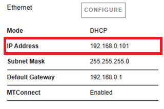

  5. Go to the Other screen.
    The assigned IP address for the connected plasma shows in the field near IP Address in the Ethernet section of the Other screen.
    This image shows an example screen with an Internet Protocol address that was acquired through aDynamic Host Configuration Protocol-capable router with an Ethernet LAN interface.
