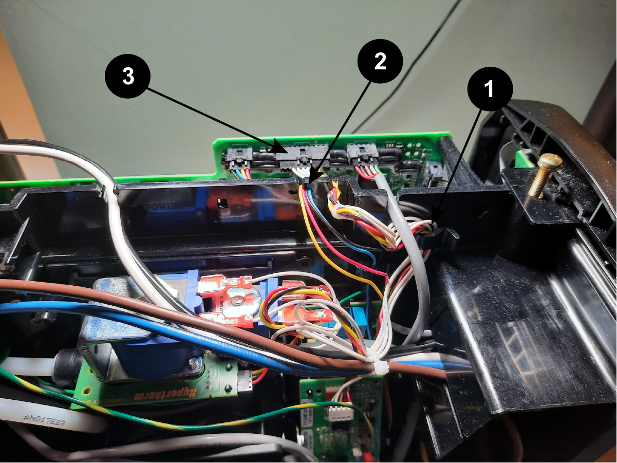

  4. Plug the solenoid valve connector into J8 on the power Printed Circuit Board (PCB).
    The image shows the proper wire routing for the solenoid valve.
    1 Plastic clip
    2 Wire pass-through
    3 J8 solenoid valve connector
  5. Make sure the wire connections on the valve are secure.
    The wire length should allow easy routing to the power PCB and should not be taut.
