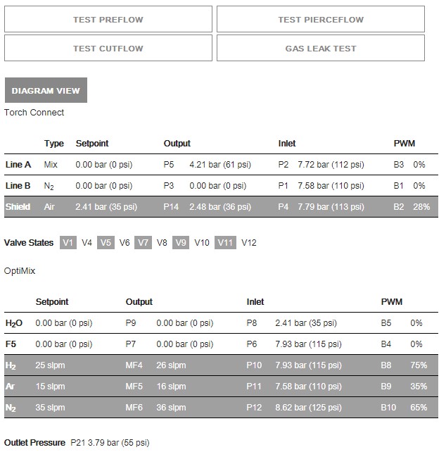

On this screen you can monitor the status of the TorchConnect™ console and the gas connect console. You can also see which valves are active when the gas is flowing.
There are two view options for this screen.
Text view
In text view, text identifies real-time gas pressures and currently active valve states. When a valve is active, the screen shows it as gray.
Both bar and psi units of measure are shown on this screen.

The test starts when you choose the button. When the button is active, the screen shows it as red. Active valves show gray. The gases on Line A, Line B, and shield align with the process ID that you selected. The gases flow for 60 seconds unless you choose the same button or choose another button that stops the test.
Figure 1. Example text-view screen that shows the gas system status
