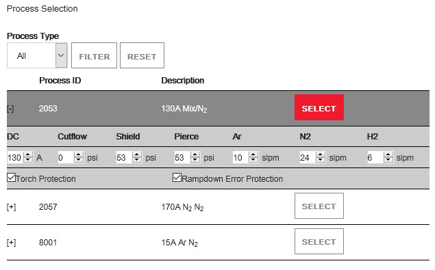

Operate screen
On this screen, if you have the device that is in control of the plasma power supply, you can select a process ID that aligns with the material, thickness, and process type.
You can customize some parameters by choosing the + to open the menu. The plasma power supply keeps this customization until the remote on-off switch is set to OFF or the power is removed from the plasma power supply. The customization is also reset when you select a new process.
Figure 1. Example of an Operate screen
