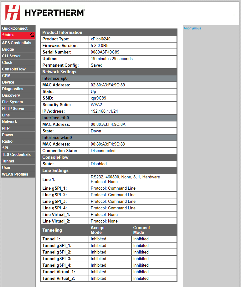

  1. Use the procedure in Use AP mode to connect to connect the wireless set-up device to the plasma power supply.

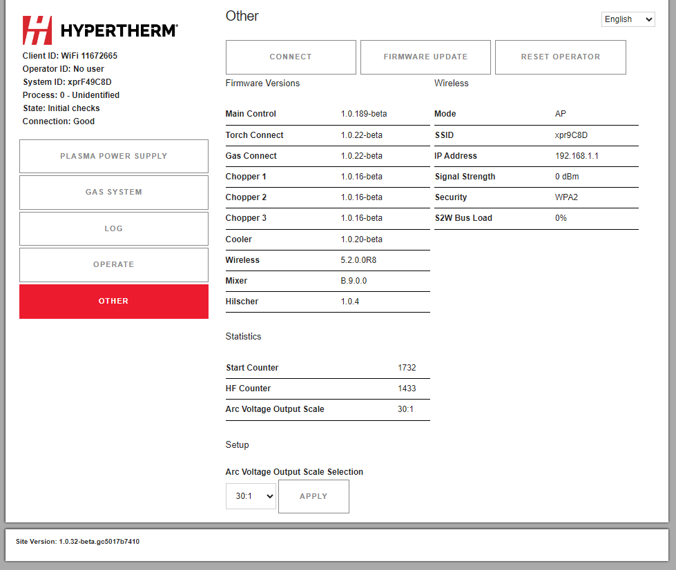

  2. Choose Connect on the Other screen to open the Device Setup screen.
    The XPR® web interface shows different fields for different models. The screen shown is for reference only.
    The Connect button on the Other screen
  3. Use the Device Setup screen to configure wireless adapter settings as necessary.
    The Device Setup screen
