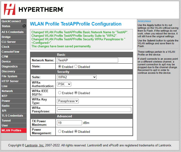

  3. Choose the profile you want and configure its settings, including Network Name, Security, and Passphrase.
  4. Choose Submit to save the profile settings and connect to the network.Test AP Profile Configuration on Device Setup screen
