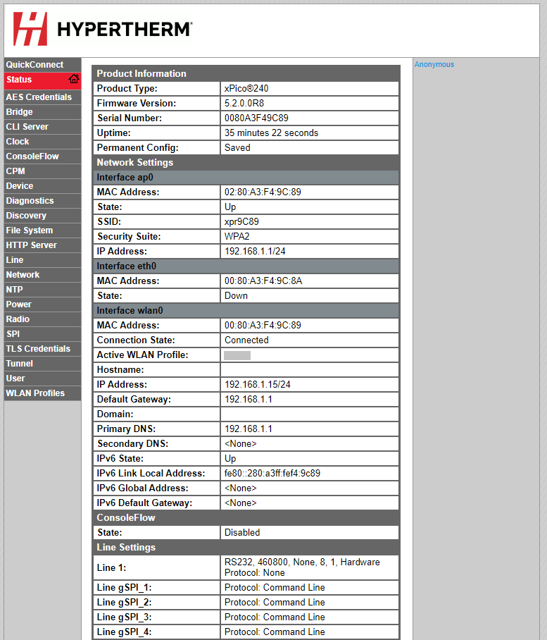

  1. On the Device Setup screen, choose Status.
  2. Look in the Interface wlan0 fields on the Status screen to find the IP address that you want.
    The Interface wlan0 fields on the Status screen.
  3. Use the assigned IP address to access the XPR web interface through Wi-Fi®.
    In the example, you navigate to http://192.168.1.15/index.html.
