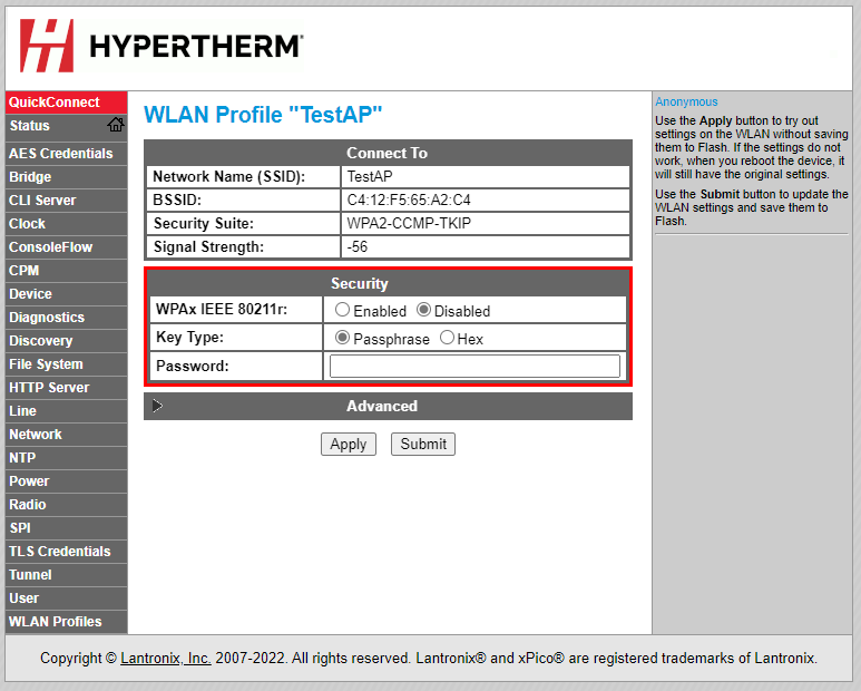

  2. On the WLAN Link Scan screen, choose the network that you want.
  3. On the WLAN Profile screen, enter the network password, then choose Submit.
    Enter the network password on the WLAN Profile "TestAP" screen.
  • The network is now connected.
  • If you are monitoring with the XPR® web interface through Wi-Fi®, you are done.
If you want to operate the cutting system, you must connect to the plasma power supply with discrete. Refer to Connect to the plasma power supply with discrete.
