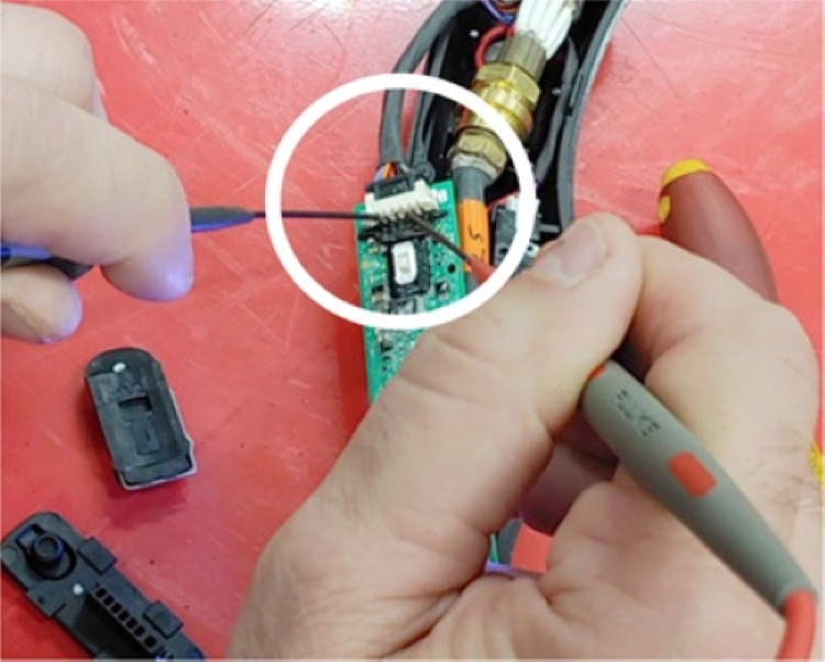

Corrective action for the torch (0-98-2)
  1. Connect the SmartSYNC torch to the plasma power supply.
  2. Remove the left side of the torch shell.
  3. Make sure that all wires are correctly and securely connected to the torch PCB.
  4. At the torch lead receptacle on the torch PCB, measure the voltage between pin 3 (black wire) and pin 5 (orange wire).
    Keep the wires from the torch connected, and measure the voltage at the rear of the receptacle, as shown.
    The image shows the pins to test in the torch Printed Circuit Board.
  5. Is the voltage approximately 15 VDC? OptionDescription
    If yes... Continue with the next step.
    If no... Continue with step 9.

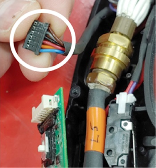

  9. Disconnect the torch lead connector from the torch PCB.
    The image shows a detailed view of the 6-pin connector with wire colors.
  10. Put the multimeter leads directly in the sockets for pin 3 and pin 5, and measure the voltage between pin 3 (black wire) and pin 5 (orange wire).
  11. Is the voltage approximately 15 VDC? OptionDescription
    If yes... Replace the power PCB.
    If no... Continue with the next step.
