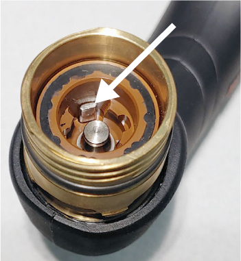

  7. Push down the plunger in the torch head and then release.
    The image shows the plunger in the torch head.
  8. Does the plunger move freely and go back to its start position? OptionDescription
    If yes... Continue with the next procedure.
    If no... Replace the torch body.
