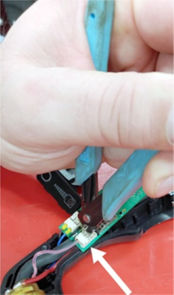

  4. Disconnect the two antenna wires from the torch PCB.
    The image shows the removal of the antenna wire.
    1. Lightly push down the tabs on the antenna connector on the torch PCB with your thumb or fingers.
      You can also use a tool to push down the tabs if the points are not too sharp. The pliers shown are one example.
    2. While you hold down the tabs, pull the antenna wires out of the connector.

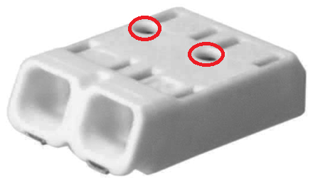

    Note:
    If the antenna connectors look like the one shown here, insert an object such as a paper clip into the holes to release the antenna wires.
    New 2-wire connector.
