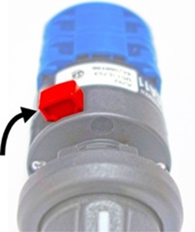

  9. Attach the power switch to the front panel:
    • 1-phase models: Attach the power switch assembly to the front panel using 2 screws. Tighten to 1.1 N∙m (10 lbf·in).
    • 3-phase models: Set the knob to the ON (I) position. Press the switch assembly onto the shaft of the power switch knob. The red latch should be in the "LOCK" position as shown. Press until the assembly clicks and is securely held in place.Image of the power switch knob.
  10. Set the front panel into place so the tabs at the bottom snap into place.
    Make sure no wires are pinched as you put the panel back in place.
