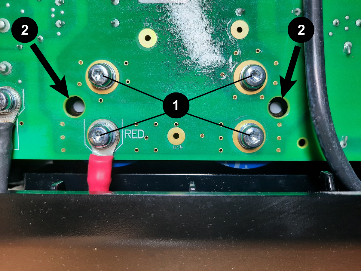

Corrective action for VBUS faults using the capacitor terminals (3-00-0)
Do a test of the power PCB to make sure that the circuits are balanced. Use the capacitor screws to do the test. There are labels on the rear of the power PCB for the positive (+) and negative (-) capacitor terminals.
  1. Wait approximately 10 minutes for internal voltages to discharge.
  2. Loosen the capacitor screws enough that you can disconnect the capacitors from the power PCB.
  3. Measure the resistance across the capacitors, and make sure that the resistance is approximately:
    • 13.5 kiloohms (kΩ) for 1-phase models
    • 18 kiloohms (kΩ) for 3-phase models
  4. Do a visual inspection of the capacitors.
  5. Replace the capacitors if you do not see white dots in the vent holes next to the capacitors, as shown.
    Always replace both capacitors at the same time.
    Refer to Remove the bulk capacitors.
    The image shows the capacitor screws and the white dots in the vent holes in the power Printed Circuit Board.
    1 Capacitor screws
    2 Vent holes
