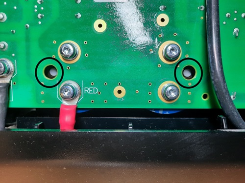

  6. Put the power PCB into position inside the plasma power supply.
    Note:
    Make sure that the white polarity dot on each capacitor aligns with the viewing hole on the power PCB.
    The image shows the power board with the dots aligned.
