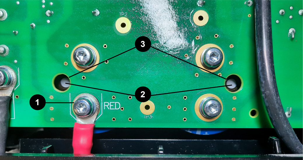

  3. Attach the capacitors to the power PCB with the 4 mounting screws.
    Secure the transformer wire to the RED location. Start the 4 screws by hand then tighten to 2.3 N∙m (20 lbf·in).
    The image shows the backside of the control board showing the capacitor insertion points.
    1 Transformer wire
    2 Polarity dot
    3 Viewing hole
